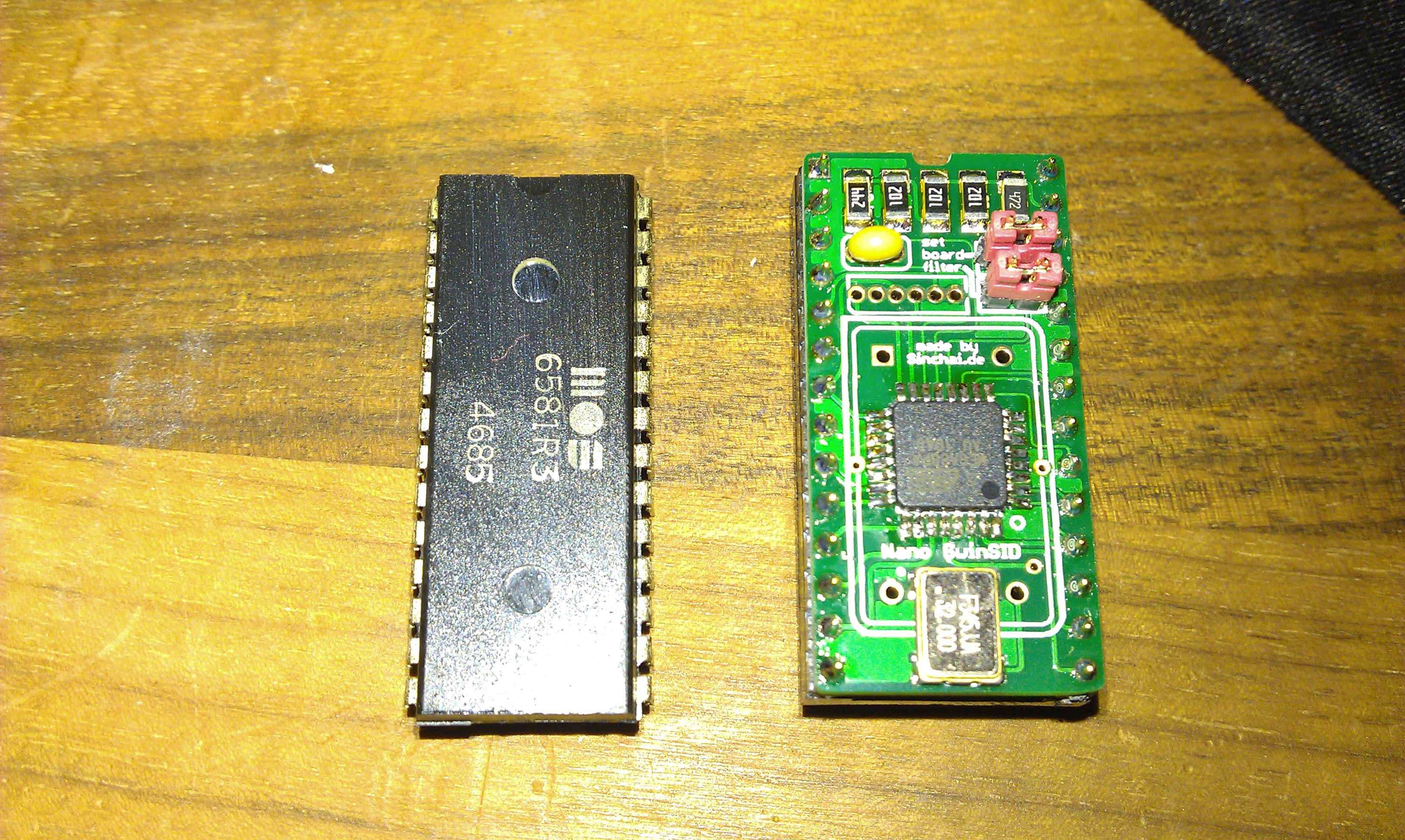

Got myself a couple of these SID replacements today.
I first saw them around April this year but have not been available to buy until now.
As you can see they are around the same size as the original and my first impressions are very good.
There are 2 jumpers on these.
The top one needs to be removed for older C64’s. It has something to do with resistor R3 and bring the volume level up.
The lower one is to switch between 6581 and 8580 emulation. A switch could also be added here to switch between then on-the-fly.
To test these against an original 6581 I used the SIDPlay program running from SD2IEC and fed both the samples into a PC to record them.
The most noticeable difference for me is the volume level on the original is far higher and I also think its a better, cleaner sound BUT as the SID chips are now going for stupid money by opportunists on eBay then this is a really nice alternative and one that will come in very handy in the future for many people.
